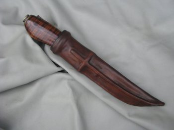

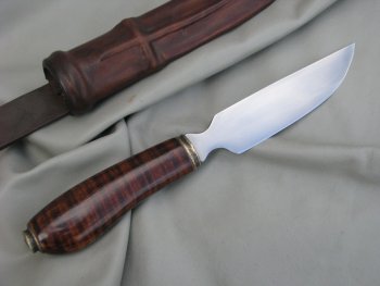

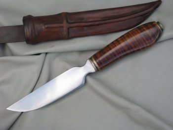

Finally got around to making my pastor a knife plus a sheath. The blade was forged out of a piece of 3/4" 60 grade rebar. Since he was in my shop when I forged the blade I thought I'd use the forging for his knife. Use a piece of curly maple that was saved out of the firewood rack and used some aluminum bronze that I aged. First sheath I made in several years and it turned out better than I expected. The knife is around 10" overall.

Beautiful work!
I would love to know how you finished the handle (Maple?) and how the sheath was made.
Top shelf right there. I know he will be mighty pleased.
Beautiful work!

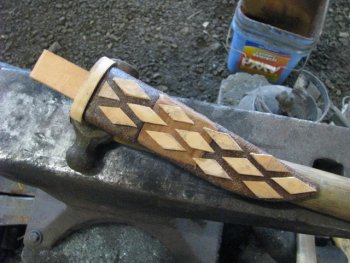

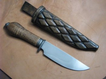

Thanks..... As far as the handle goes its sand, sand, sand. Dyed it with the same dye I use on the sheath.. Then sand, sand some more. I used a water based finish that a hardwood floor finisher had given me. I'll need to check on the name. I put 4 or 5 coats on with a light sanding between coats. Used my finger as the brush.
I make a two layer sheath, inner and outer. I first wet form the inner sheath around the knife. When that dries I can make adjustments as necessary Then I'll put contact cement on the front and in this case I'd fasten the diamond shapes to the inner sheath. After this process coat the whole sheath with contact cement and apply the finish piece of leather that also has contact cement on it. Lots of steps so could be continued later.
