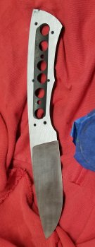

Ps I know the hole drilling is outta control on this one lol5C35AA4B-2771-4797-8161-5FDCF9DBB5FC.jpeg
Looks good. I agree with light duty. The two holes in the think part of the hilt would limit heavy work.
I’m even thinking of a SS liner. I may even scrap this one or keep it for myself. I think someone could step on it and pop it once hardened.

I don't see those holes as problematic...I'd skin anything I could with that...you'd have to use it as a pry bar before you could tweak that handle (provided it is heat treated also)
The holes aren't making that knife weak. It's not a climbing peg on a telephone pole- it's a knife. Knives cut things. How many steak knives or fillet knives have you ever snapped, especially snapped in the handle somewhere?
Look, I'm all for sturdy construction. But a knife slices things. A chopper chops things. A knife meant for both does neither very well. Therefore, make slicers that slice. Anyone who breaks a slicer is doing something really, really stupid.

Always put your name on a knife. You put a lot of time and energy it to them be proud of your work. John's statement is spot on for the holes. I swiss cheese mine all the time for weight reduction.

yes, but the knife is probably .100 at the thickest. Plus don’t yall think that the holes are in bad spots? Y’all know way more than I so these are real questions. I really don’t know how strong steel is to begin with I guess is what I’m really trying to say.
None of those holes are at a "hinge point" where if you were really prying hard they would affect the stiffness of the handle. They're fine. deep breath...and ...get that handle on...LOL!!
Exactly. It's .100 at the thickest. Any reasonable person who picks it up will realize it is not meant for splitting firewood. It is, however, in that sweet spot where it will cut like a laser. Knives are tools, and purpose-built tools are where performance is found.
As soon as you put scales on that thing it will stiffen up considerably. Have you ever used steel studs in construction? When you pick one up you think "This must be a joke. I could bend this in half with my hands." Then you screw them into place and put drywall on them and the wall is now amazingly strong.
I'm not saying you should think of scales as being structural. But they will stiffen that knife more than you expect. Again- it's a slicer. Make choppers that chop and slicers that slice. If the knife cuts as it should there will never be a reason to force it.
