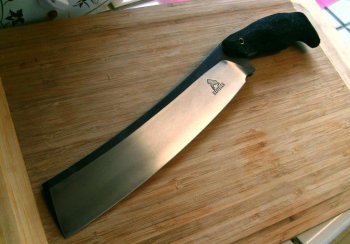

This is the knife Ted Ott used to win the 2010 World Cutting Championship at the Blade Show.
