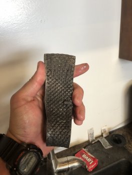

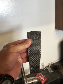

A friend of mine who is also on this forum suggested to me to soak my tomahawk heads in battery acid over night to clean the scale off. I’ll try to post a pic tomorrow of the outcome
I already had them soaking by the time I saw this, I had them in a chemical/acid Safe plastic tub outside where nothing could get into it overnight then this morning I fished them out with a wire and soaked them in a very strong baking soda and water solution to neutralize the acid. When they first came out they were coated in bluish green Crystals. After soaking for a few minutes in baking soda the crystals disappeared and they’re looking pretty good, I rinsed with cold water and put back into fresh baking soda and water, they will sit until they don’t bubble anymore...

Jon, I have heard of folks using Sulfuric Acid for etching. How ever the hazards of using battery acid aren't really worth it, given the fact that vinegar will do both. Loosen scale and some use it too etch!! Let them pieces set for a bit and see if they begin to rust.
I did some with heavy salt and even after rinsing, scrubbing with baking soda, and rinsing again I thought I was good. About a week later I noticed the steel was beginning to rust!! So now I do a double baking soda rinse with a waiting period of at least 24 hrs. between the first and second rinse. I haven't had a rust problem since I started doing the double rinse!!
I keep a spray bottle full of glass cleaner WITH ammonia and I hose it down and wipe it off two to three times with that. Dollar general brand works well if it has the ammonia. I try not to use water but it is good to know it works with baking soda.
