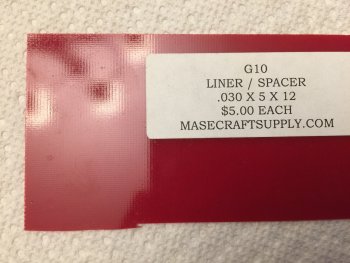

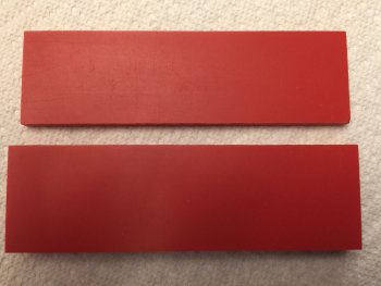

When I first started making knives I searched and searched for handle material that was “cornhusker” red. G10 Red is not Husker red. Probably not the best pictures but you get the color differences. Top is g10 bottom is corian. I finally found a sink cut out in corian. Way better color fit for the Huskers.

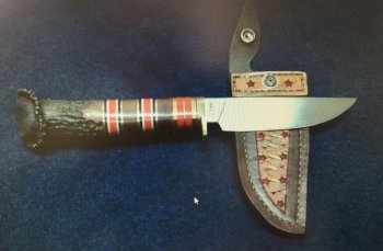

Cliff-Is this what you want to build? Combination of g10, brass, corian and antler. If so, do a bit of research on an old master by the name of “Scagel”.

Thanks Dennis, what I am working has a similar handle but it is not that!! This knife was inspired by a character on the old Walton's Mountain show. He was only in two episodes and in one he had to go to jail for moonshining. He gave Johnboy his knife to hold. The knife caught my eye and well that is what I am about to try!!
Just looked up Scagel. I knew I had heard the name before! He did a lot of work similar to this piece I am working on!! It is possible after looking at Scagel's work the knife could have been one of his!! The knife belonged to Boone Walton on the show and it actually only shown but, for a fleeting moment in the show. In all actuality it looked out of place for the time period but, the look of that knife stuck in my mind.
