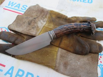

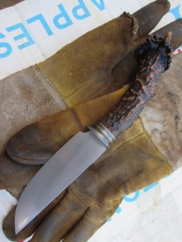

Finished this one up yesterday. It had been pretty much done for the better part of a year. I'd done a mustard patina on it but just didn't care for it so I decided to rub out the blade and I like it much better. I'd picked up a few racks of 1932 Studebaker leaf springs several years ago. Wasn't to impressed with the hardness at the time but do believe it gained hardness after sitting for a year after heat treat. 5" blade and 10" over all. Pretty sure the crown was from a white tail deer. Wagon wheel was used for the fittings.

Not many people can say they have a knife made with a leaf spring from a 32 Studebaker..That fact alone makes this knife cool. And it looks good too. Nice work Raymond. But the sheath looks more like a work glove, might want to do something about that. :)
Very nice looking knife there. I like the wrought iron fittings and the clean blade. The handle looks a little dark for white tail, did you dye it?
Thanks everyone for the kind words!
Very seldom will I not dye antler. This piece had so much texture it would be very uncomfortable to use if I didn't remove some of it. I just like the looks of the antler when it is darkened.

Studebaker springs, that was Rudy Runa's favorite steel. great looking knife.
Gary, When I went to get these leaf springs my mind was set that they would be 9260 but after I did my first few test I discovered this was not what I was hoping for. 1932 was the middle of the great depression and I'm sure they used what ever they had for spring stock. I should have known better when I noticed several of the leafs were broken. I did contact the fellow I'd gotten the springs from with the hopes he would want the knife but I am sure the price I offered him was more than he expected. I've used bits and piece of Studebaker spring over the years and it was good steel but really not much difference from 5160.

Its funny about not losing my touch. It just seems to happen on its own. None of my knives are planned except if I am doing an order and then I tell the customer it will be similar. I'll do the blade as close as possible but very seldom will I make a pattern. Everything is still done eyeball close. I do appreciate your comment!

I sharped the blade today from the 32 Studebaker leaf spring. I can't do any heavy duty testing anymore but it did take a nice edge and actually cut pretty good. Not sure if I mentioned that the blade sat for at least 3 years and to me it seemed to get harder over time.
