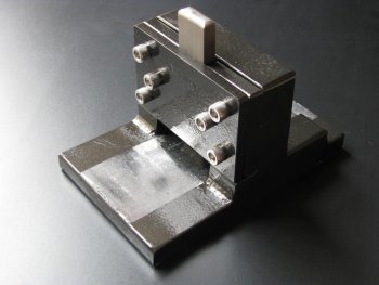

tang stamp holder
Here's what I use for a stamp holder. It's built by Owen Vernon.
