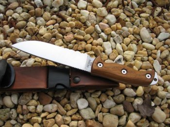

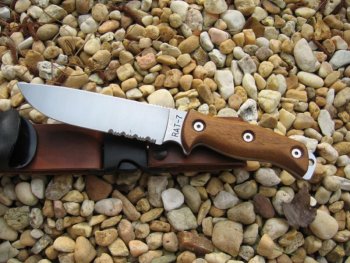

Finally got around to this project though not on the intended knife - A buddy approached me about making a kydex sheath for his Ontario Rat 7. When he showed me the knife (a beater) I noticed the micarta was damaged and asked if he would mind if I changed them out.
It wasn't till last week that I had time to work on it - light work on the finish with 300 grit sandpaper, tried to clean up some damage done batoning, smoothed the spine, attached the TEAK. Spent most of yesterday hand shaping the the handles using 220 grit. Still a ways to go.
What's the best way to treat the handles? I have Watco Teak oil finish. Is there something else I should use?
Snapped a few pics with my camera yesterday, will post em when she's all done - hopefully by this weekend.

Finally finished this project, have to go back and see what the date was on the first post.
attachment.php
attachment.php
edit: got the photos fixed
T
NICE! I love hard-use knives with a touch of class. Did you find the teak difficult to work with?
Not at all. Went really slow, took my time, was worried about making some irreparable mistake and having to start over again. Did have some trouble using a counter sink - I didn't clamp it down, got the first three holes without issue then it started "hopping" on the third... lesson learned.
