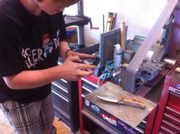

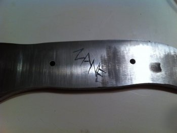

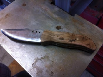

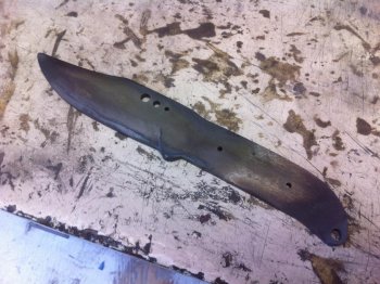

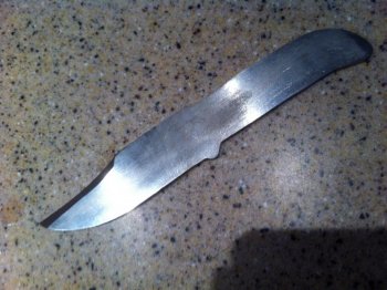

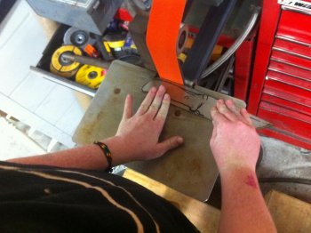

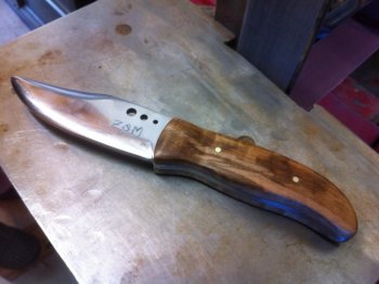

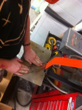

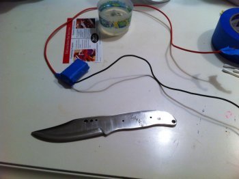

For Christmas my family picks names and makes (not buys) presents. We have fun with it and the things made are of legend. not really. So my son loves to go all out (he's 13) and this year he wanted to make a knife. I said ok and off he went. I helped with the edge grind and tech support he did everything else. Once he had the shape and edge I went to my buddy Brad's (BZ Knives) in Homestead and heat treated (61.5) then in the cryo (62.5) and back home for two 500 degree tempers. The details are S30V, Curly Maple handle with brass pins and a rounded edge (don't know what to call it).
