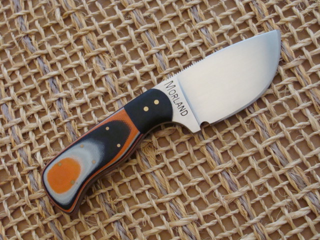

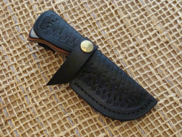

Here is a couple of similar knives that I have made. Also, a couple of sheaths if you are interested.

Those look good Retro, and I'd agree it looks like Cocobolo, I can't use the stuff it kills my sinus's and throat.

Love those sheaths. What grade/weight leather is that.
7 oz. If I remember correctly. Just pm me if you need any help with a sheath.
