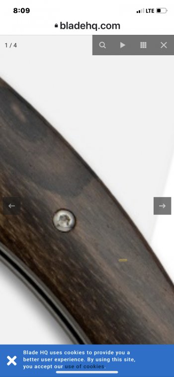

What are these called and where do I get some
Chris Railey
I need some of these small screw fasteners. Where can I get some?

search torx screw on usaknifemaker, host of this forum, they have many sizes.
These are small screws that you can get through most knife supply outfits. However, I would caution you to thoroughly check out exactly what you are getting, BEFORE ordering.
Why? One word.... Tolerances. These screws/hardware are tiny to begin with, and generally used in tight tolerance applications such a folders.... where a +/- tolerance of .005" is a huge deal. That .005" is usually the tolerance specs for this type of hardware that is made in China, or some other overseas locations. This applies to not just the threads, but also how concentric (how the heads are centered on the screw).
My advice, unless you enjoy frustration, is to seek out hardware of this type, that strives for as tight tolerances as possible, pay the extra money for it, and don't go the "made in China" route. Been there..... done that... and didn't even want the T-Shirt. ;)
