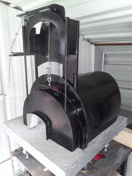

A ribbon burner is a dream come true. Even heat, low fuel consumption, even heat! The cost is not much more than a forced air forge, if ya do some homework.
I designed mine off a couple ideas I had seen on another forum.
IMO it was and is worth the extra time and cash.20190521_200115.jpg20190521_195846.jpg

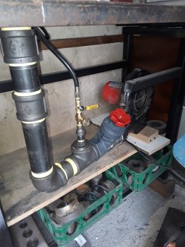

Peppie, what are the pipes on your ribbon forge made out of?
They are steel pipes from the local hardware store. They sell them pre threaded at different lengths. All at 2" diam. 2" brass gate valve to regulate the air from a bounce house blower. There is a perforated 1/8" steel baffle in the long steel tube going to the burner that aids in mixing the gas and air. I used a needle valve to adjust the fuel flow.

To compliment Peppie..... that forge is one of the better built, and more well thought out ribbon burner forges I've seen.....NICE JOB!! I like the "dam" in front of the burner, and where/how the burner enters. I do have one question..... are those little pipes coming out before use? If not, I suspect they will be eroded/burned off after a few used/firings.

TY Ed, the little pipes coming out of the burner are the pen blanks I used to create the ports in the cast burner. I left them in the burner for pictures to show the direction of the flame exiting the burner. They were removed before firing the forge.
I think that may have been what Sean was asking about also.
Sean Jones
Yes it was. I was wondering the same thing. Thanks for understanding my slightly muddled question.
