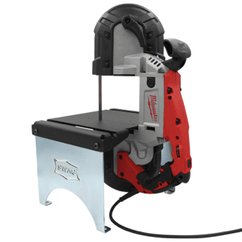

band saw for sure. You won't hate cutting the profile as much as you do now. The cheap 4x6 from Harbor Freight is a good deal but you will need to replace the sheet metal table to something more substantial.
If you are working on fixed blades you won't use a disk that much but on folders you will use a couple dozen times or more for deburring or getting parts flat. I should change that a bit. If you do scandi grinds on fixed blades, a disc grinder is significantly better than a flat platen on a belt grinder. Still, I'd get the band saw first.
I vote for the bandsaw also. I look at it this way, every single knife I make takes a ride thru it at some point, but my disc only really see's liners for folders, and that one runs at a slow speed.

OK...unless someone else says something significant otherwise band saw it is. I found a used Milwaukee portaband saw the other day for a $100.00 with some extra blades. I'll have to give him a call before it goes by-by
I think you'll be very happy with that decision. I have a Dewalt and a SWAG table. Makes life so much easier.
Nothing has made a bigger impact on my time to complete a knife than going from a cutoff wheel to a HF porta band and a Chris Made vertical holder...
Bandsaw for sure. Cutting scales on a metal saw is no fun, but it’s definitely possible. In that regard the machine is a two-fer because it offers you redundancy if your wood saw goes down.

The portaband mated up with a SWAG table is a metal eating monster.
I used mine for several years but upgraded to a Jet 14" mainly because of the 5" throat depth on the Milwaukee saw.
For a minimal investment you won't regret it.
I picked up the Milwaukee band saw today. It's an older model but in good shape. I'll have to check the model number in the A.M. to match up a SWAG table and post some pics.
