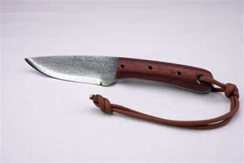

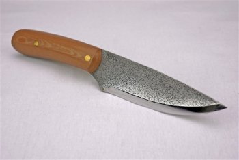

Hi guys I just designed a bushcraft knife that I’m really liking and would like to make a lot more of but have a few questions on how to keep the finish of the Scandi edge nice and clean after I sharpen it on the stone. Since a Scandi edge is sharpened with the whole flat down on the stone and no secondary or micro bevel is supposed to be on it, the stone scratches my scandi bevel. I’m totally cool with that after the customer has bought it and sharpened it themselves but I don’t want to sell knives with sharpening scratches in them and want to keep everything nice and crisp. Anybody have any tips on how I should go about this? Should I work on only establishing a sharp edge on the belt grinder and forget the stone or......
I went straight to the edge with the flat platen and then went to the stone to really make it sharp. I took the blade back to a scotch brite belt and cleaned up the bevel with the edge down and it did help the finish and didn’t hurt the edge I had established on the stone but didn’t get all the scratches out from the diamond stone. I could go back to the belt and clean it up but I’m kinda trying to keep from that if there is a better way since the scandi is a difficult grind anyway even with my jig...
Btw... Blade is 80CRV2. 5.25” cutting edge and 10” OAL. OD Green G10 with Coyote Brown liners.This is my first Scandi grind and I still have some kinks to work out to get grind lines straighter and crisper but anyway, it’s a start. Anyway, any help or tips would be very much appreciated
