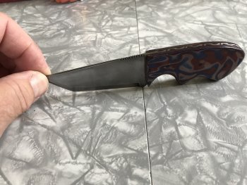

Thanks Ken,ya being a bandsaw blade it’s fairly flexible especially lengthwise. I have been making knives a while so have tools. Yes was going to use an angle grinder for initial shaping. Thanks again,pics when done. Here’s the latest knife from said saw blade
