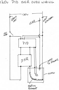

Here's how I wired mine, sorry I can't help with element size, it was in place when I did the PID conversion.
