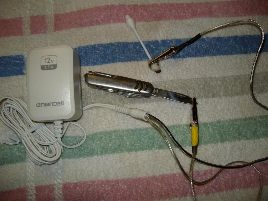

I was reading on the internet today trying to find information on plans to build myself an etcher. I ran across a person saying that you can use a 12v DC power supply. I figured I would give it a shot. That person said I would need a 12VDC 2.5 amp power supply. When I got to radio shack tonight, all I could find was a 12VDC 1.5 amp. I bought it anyway and came home to test it out. This is what I found. $25 for the power supply.

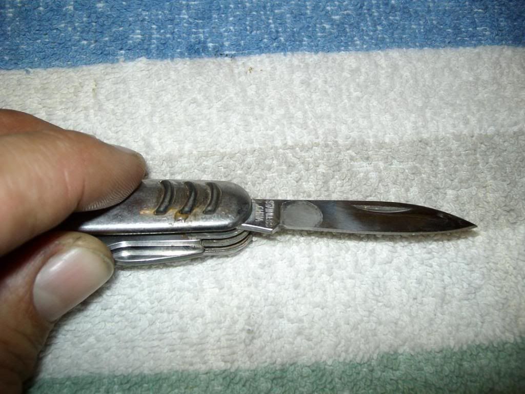

At first I hooked it up with the negative alligator clip on the tip of the blade and the positive clip on the end of the Qtip. I soaked the Qtip in saltwater. This produced a sizzling sound, but no results. So I swapped my clips and put the + on the blade and the - on the Qtip. Wallah :D it worked. It started dong something and actually turned the blade dark. This is a small cheap pocket knife I had laying around so I used it for the test. Hard to see in the picture, but the etch worked and the blade has a medium gray mark.

You will be able to etch with the power supply but you need an ac side to put the black in the mark.

I used a 6/12 volt battery charger with great success before I actually bought a real machine. I tried it with my motorcycle trickle charger and it worked too. I'm not sure but it seems they operate on the same prinipal. Anyway it worked.

I haven't built the etcher yet, still waiting on the transformer from radioshack.com to come in the mail. I can't advise on that, but when i did this trick with the plug in power supply, the only way it would etch was with positive on the blade neg on the pad (or qtip in my case).
