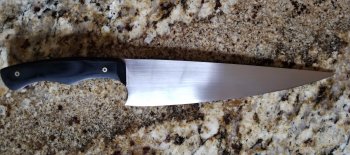

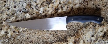

Quick background on the build. A lady at my local American Legion asked if I would build her a 8-10" Chef's knife. Of course without thinking I said yes. Did I think about the fact I never did a flat grind before? No. Hence my previous post about the Sorrell's style knife with a my first flat grind. Also, because I like Mike Stewart's videos at Ekim knives, decided the chef's knife would not have a visible plunge line. So, thankfully decided that before making it for the customer, I'd make one for my wife to try. Good thing because the knife steel, Nitro V, warped in heat treating. My fault for not having the correct size quench plates. I was able to straighten the blade, which I'm pretty darn happy about, and move on. One of the biggest things I learned in the process, was while I thought everything was good on the grind, I had a bunch of waves/ripples. I most likely wouldn't have noticed but I used Nick Wheeler's sanding method and through A Lot of sanding got them all out. The second thing I learned was as much as I wanted to leave a little extra meat at the heel, I left too much. I had to go back and then it out so it didn't look too stupid. That's why the satin finish is not up to stuff. The blade style is based on Michael Zieba's design. Anyway, here's the finished product which my wife loves, even though it bit her on the first use. Appreciate and thoughts and feedback on the knife.

While the curve toward back looks nice, that sharp point in it looks scary - is that what "bit" your wife? I think to put a very small radius on that point so it's not sharp.
Good job - how long is the blade?
That is a beautiful piece of work. It makes me think of something from outer space - a futuristic shape. You should be plenty proud of that one. And thanks for taking the time to talk about the process!
I like the curve of the blade and the shape of the spine...I could work veggies with that real nice. Also I know the weight is back towards the handle which for me on a chefs knife handles "quicker". I love Santokus for much of my cooking but they always feel "nose heavy". That is a good knife...you did a nice job on finish too. Well done.
You did a fantastic job on that. I have to echo what has been said- I seriously recommend that you grind that sharp angle off the heel. It looks really cool, but it's going to bite you so many times when you least expect it.
I think you did a great job and Mike does some great videos because he explains everything including his mess ups and how to fix them.I binge on them often when I have nothing to do.
I totally understand the pointy heel. I'll probably heed ya'lls advice and radius it or do something different. But to answer your question, no she just wasn't use to it and stuck her finger while cutting up some cauliflower
Oh and the blade is 9 1/2"
thank you!
Thanks and I'll doing something with the angle at the heel.
