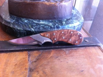

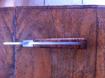

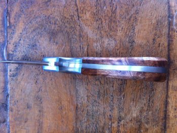

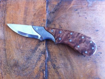

Blade: 01 Mirror Finish
Bolsters: Damascus
OAL 6 1/8”
Blade Length (Mid-Bolster) 2”
Blade Width 3/4”
Stainless pins
Grip Mesquite Burl (Stabilized)
Thickness at the tang 1/8”
Time of fabrication -- 15 hours
This little Bulldog is a knife of my own design. I try to push myself and attempt new, more advanced techniques on each subsequent project. With this one I tried to combine a Mirror finish on the blade with Damascus Bolsters. I had my share of difficulties with that combination but I'm very happy with my results on that. As always, I can find a lot wrong with a knife I finish. On this one, I'm not particularly happy with the spacing between the 10 pins - I just missed it. Also, the unexpected: I put this knife together 10 times before I glued it up and it fit perfectly. When I glued it up 3 or 4 of the pins split out the wood. I think I get a little tense and excited during glue-up and may not take as much time as I need to get it right. Oh, well, it is what it is and I will try to improve on the next one. I am very happy with this design and will probably make it again. Any and all comments are appreciated.
