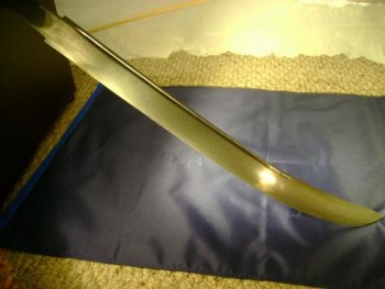

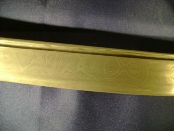

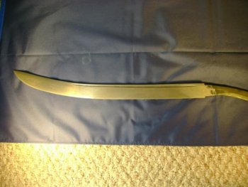

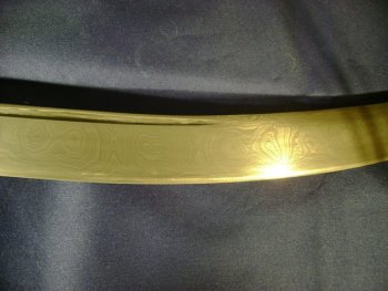

Hope to finish this with mild steel disk guard, wrought iron bolster and butt cap, and ziricote wood.
this has a complex geometry - ridged until end of fuller, then lens-shaped with slight false edge.
17" working blade length
400 layers, random laminate 1075 and 15n20
This is the first single-edged thing I have made with a really complex geometry, and the first real, viable sword. I made a lot of seaxs that were good, but they are just wedges. This is a full convex surface with proportional taper in all dimensions. Good thing I like to draw file.
This is my first dao. I encourage any comments and helpful advice.
thanks for looking
