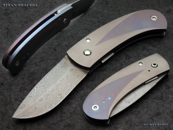

I have done it a few times on titanium and it works very well for me wit glass beads to blast with not too much pressure it will work fine.
Here a example where I bead blast titanium :
attachment.php
I hope that helps a little bit.
Regards Murat

Yes I tape it of with some furniture tape.
And I cut it out with my hands.
But I also tryed it the way as George explained it.
I have some very vine stencils from my logo ( avatar ) and it works too.
Just try it, it s not that difficult ;-)
