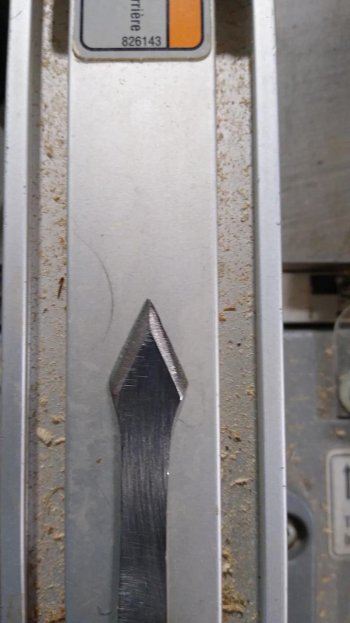

The superglue on the paper templates kept failing, so I had to keep going back and regluing it. Neither my phone nor my work computer like my fingerprints anymore :)
I assume that if I made proper hard templates out of something that I could just trace on dychem i would not have this problem. However, these may be 1-off knives that I may never make again (unlikely) but even if they weren't I may at some time make a 1-off and doing pretty much double the work to make a pattern for something I won't make again seems a bit off.
I have considered utting out the pattern more carefully, then gluing it on and dychem over it so that i have a reverse image, then just cut/grind away whatever has the dychem on it. Any other ideas perhaps I am missing?
a glue stick works better for gluing the paper to the liners. super glue fails instantly when it gets hot.
pro tip: drill your pivot pin hole before you start grinding in case you lose the paper. That hole is the key to everything.

I did, in fact, drill all the marked holes first. This is what made me able to re-attach the paper template. The super glue, on the other hand, did make things a bit more tolerable when I started dunking in water. Or I think I would have lost my lines completely.
Acetone dissolves super glue. Good to have on hand for clean-up.
