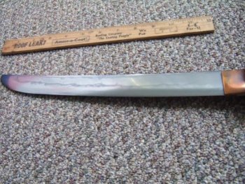

So, with this 5160 wakizashi, I gave it more curvature than I wanted and let the negative sori straighten it. The soapstone mark on the anvil shows where the spine was prior to the quench. I've never had a blade crack from sori in a canola quench.
![](http://i1382.photobucket.com/albums/ah244/Helmgrind/negsori1_zpsqlkgyshe.jpg)
While at the base of the blade near the blade/tang transition there has been almost no change, about 2/3 of the way down it has moved about a 1/4". It seems like this happens by far the most with the quasi-Japanese blades I do. It's like they know...
I've gotten pretty good at gauging how much extra curvature to have to get the blade to straighten up to where I want it, but I don't do too many in this style.
