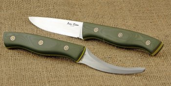

I made these two knives recently and as you can see the curved blade has a 'Scandi' grind for deer gralloching ie stomach removal in the field.
The curved blade was a challenge as I had the blade in a jig and had to move it along the belt in a sweeping/ curving motion in order to grind it as impossible of course to grind it like a straight bladed Scandi. This led to an issue where I was going off the back of the table as the blade moved around the belt to the tip when grounding....hope I am explaining this so you can follow?
Now I want to find a faster / easier process to do this curved grind. My thought are to make a table that extends a few inches behind the platen so I wont go off the back or I was thinking, though this mean a lot more work maybe a platen with a curved face that the belt would follow.....but would the belt track OK for the plunge lines?
So they are my ideas, might be dumb, I don't know but if anyone can help me or point my to videos that might explain this better it would be much appreciated.
Thanks in advance
Pete

Try a bubble jig it is as close to free hand as it gets and you will learn freehand faster.
I have done free hand on hollow grinds but I think I would find it difficult to be precise on Scandi grinds..:(
Though I have thought of getting a bubble jig before.
Cheers

If I was going to grind a "curved" blade. Curved more then a normal blade I would find a way to tip my Bader3 90°. A vertical grinder would help. Good luck.
Thanks, I will crack it as thee one in the image was my first ever attempt and thinking about it I jigged it first and thought it ok but if wasn't sharp enough. I then did it every so carefully free hand....I forgot that bit.
One of these days I'm going to make a karambit or a kris blade. I'll make a mounting plate with a way large hinge. Sometimes 0,,, sometimes -90°. It's all good. Best of luck to you.

Well in the end I opted to make a new table for my grinder. A long table in order if I want to make a kitchen knife and use a jig I can and I also put a deep slot in the table with a 'V' shape (v formed by either side of the slot edges) so the grit can escape when grinding. I can now sweep the blade around the sides of the belt without running out of table support. I spoke to my mate about this who does curved blades the same way and it was a case of why re-invent the wheel?
I am though going to learn to free hand, I know I will be able to do it but it is just a mental block , like writers block I suppose. I can do a hollow freehand so why not a flat ....grrrrr . I think I will buy a bubble jig and give it a whirl also.
Now get on and get those two blades ground out :)
