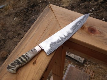

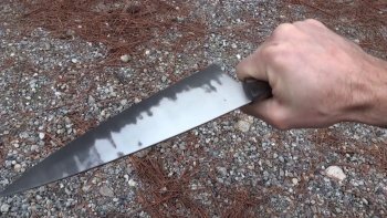

Here are some examples that I've done of Damascus cores with Stainless laminate...
There is a pretty steep learning curve when mixing/forge welding carbon and stainless steels. As I said above..... start with the carbon steel laminates (10nn/15N20) and learn all you can...... then you won't get so frustrated when you have failures with carbon/stainless. (although even those who regularly do carbon/stainless mixes have a fairly high failure rate....just the nature of that beast)
