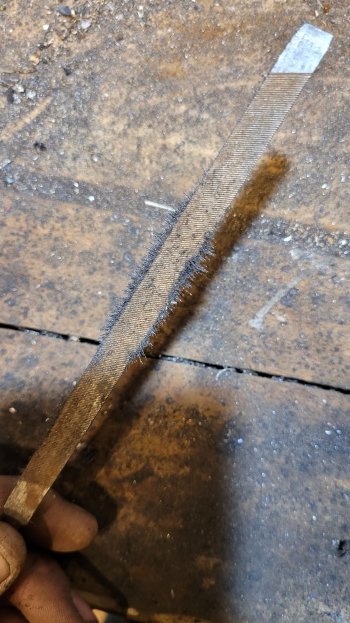

I was just out in the shop cleaning all the random junk off a workbench. I have a soft jaw vise on that bench and I used it to hold an axe head while I roughed it in with an angle grinder... My files are magnetic, my twist drills are magnetic... look at the amount of grinding dust on the bench. The whole bench and the wall behind it (and everything hanging on the wall) is COATED!
