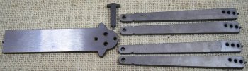

As for the bali-kits,I'm pretty stoked,and will be getting some when the IKBS is worked out.
One thing I'd suggest in regards to shipping though:NEVER ship a finished blade
with the handles!
If someone sends one of these to a friend,family,customer,send the (finished)blade separate from the rest of the components!
(I've had a few bali kits sent to me from the States this way:I'll order a bunch of stuff,and simply have the bali blades shipped with other items)

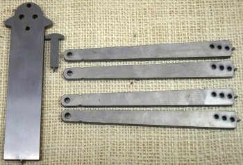

This kit looks good. I like the Titanium slab handles. Is it Grade 2 or Grade 5 Titanium? I don't really understand heat treating Titanium yet but I want to learn.
This is my first post here. I am in the middle of making my first bali. I bought a kit with solid stainless handles that had been heat treated so were difficult to modify. I tried to make handles for the blade, then realized I could make my own blade as well.
