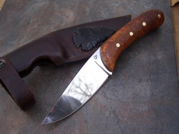

I turn off the flash and do it out side when I can. I don't get too bad of a result.
