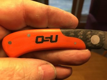

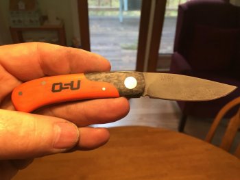

Thought I would make a folder for a friend of mine and wanted to try a couple of ideas I have had for a while.
I have wanted o do some inlays with colored epoxy that might allow me to do more intricate designs in the future.
i carved in the Oregon State Beavers logo into my orange G10 scales, did a little undercutting to make sure things would stay in place under daily use. When I mixed the epoxy, I added some analine die to turn it black. It did a great black, but will have to find something else in the future because the die seems to want to bleed even after the epoxy is set. I had to come back and seal the logo several times with thin cyno to get it to stop.
i added carbon fiber bolsters to add another bit of interest. Boy is that a messy bit of work, glad I have a good respirator!
Overall I'm pretty happy, but will have to work on getting the process to where I think it needs to be. Will have to figure out how to keep the darn G10 cleaner while I'm working with it.
G10/carbon fiber scales
410 SS liners
O1 back spring

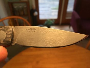

feather Damascus blade. ( billet from Randy Hasse )
6" open
