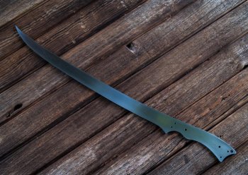

Started another project today. Im calling this one the "Barracuda". This knife is 17 1/2" long with the blade at 12" made from cpm154 @ 3/32" thickness. Going to go with bolsters front and back and micarta handles. We'll see how it turns out. Shooting for about a 59 rc treatment on it, i think that should be just fine.

Yes sir! To be honest I think the challenge is going to be getting the grind lines even on such a thin blade but by using a wooden stake as backing support I think it should be fine. Any thoughts or suggestions would be greatly appreciated.
