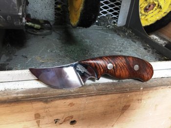

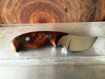

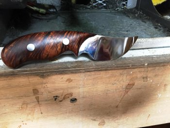

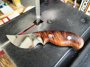

This is another short fat little knife that may be more useful than my last one, "The Thread Cutter" It is about the same size as the last one but I added a safer and better designed place for the index finger (I'm sure that little thing has a name but I don't know what it is). It is really fat and fills your palm. Also the handle extends farther out onto the blade to allow a spot for your thumb. It'll be a while before I can test it on a real animal but I hope it sells before then. Let someone else field test it and give me the feedback.
The specs are:
Blade material: W-2
Blade Finish: High polish
OAL: 6 3/4”
Blade Length: 3”
Blade Width at Plunge Line: 1 1/8”
Blade thickness at Plunge Line: .190"
Handle Length: 3 1/2"”
Handle Material: Hawaiian Koa
Two pins: 5/16'” Stainless Steel
Handle Finish: Danish Oil and Paste wax
Time of fabrication: 8 Hours
Tell me what you think - I can take it.

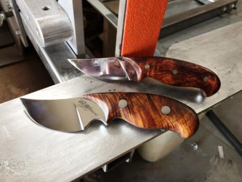

Here is the last two side-by-side
Thanks for looking,
Wallace
