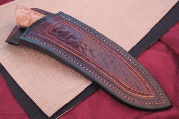

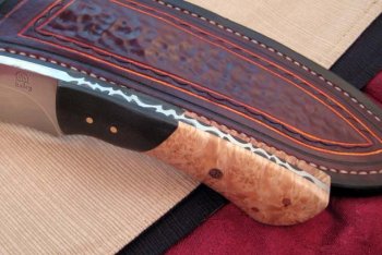

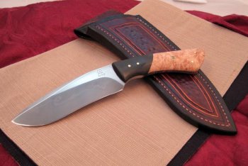

Here is one for a customer. It is forged 1095 with stabilized maple burl. I think it came out well. I hope he likes it. It cuts like a lightsaber.

Thanks, guys. I have been practicing my leather work, and with some help of this here forum, it has been improving.
Congratulations - well done.
I gotta learn the curved-grind line technique...

That curved grind line is a new acquisition for me. I decided this year to learn how to do it. I am still learning (story of my life!) and think I have the basic technique down. I hang the belt about 1/4 inch over the platen when doing the plunge cut, and do it with a sweeping motion. Sometimes it works out better than others. This one was OK.
Sometimes, it takes me almost as long to make a sheath as it does to make a knife. My sheaths improved mostly when I stopped looking at it as a burden that had to be done, and started looking at it as just another step to producing a finished knife. I rarely produce a knife without a sheath, and when I do, they are kitchen knives.
Very nice. Love the shape of the knife and the blade grinds. Nice piece of wood also.

Thanks for the little tip on the curved plunge lines....they look very nice.
Im going to try it.:D
That knife just looks perfect in that sheath. Outstanding work.

That's a nice one. I love the blade shape and the swedge is sweet!
