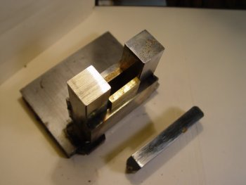

I just completed a holder for my stamp, I use it in my 25 ton press. I'll take a pic tomorrow and post it. May give you an idea.
Fred
I use a 25 ton press, this fixture was set up with that in mind.
The tolerances are important to make sure the mark is in the same location on the piece being stamped. The two upright post were matched with the plates on each side and mig welded. [lower heat] Once this assembly was welded and checked for clearance with the stamp; then the bronze shims. I used the shims so I had the option of moving the stamp one way or the other. The upright was then welded to the plate base, making sure its square.
This fixture is set up to mark Bubble Jigs, but can be altered to mark blades.
Hope this is helpful, Fred
Good idea Fred thanks for showin me the pics
Yes, the Henry Evers stamps are the finest. I bought my first one and quickly ruined it on hardened steel. Be sure the steel is "pre-heat treated" otherwise it flattens a $150 stamp. Don't stamp it hot either just make sure the blade is nearly finished sanded and annealed.
