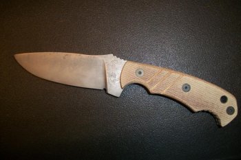

i believe he said it was a acid etch with the stuff you get from radio shack, i have some d-2 i will give a soak and tell you how she goes, or i will just call art lol. Here is the etch on mine arts was much darker then this!

Franklin, yes let me know how the D2 comes out- I need to buy some ferric chloride and try some etching as I have some D2 tacticals lined up next and a good etch is something I want to learn- thanks.
