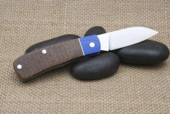

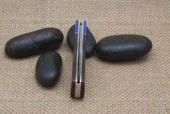

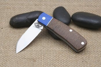

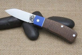

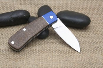

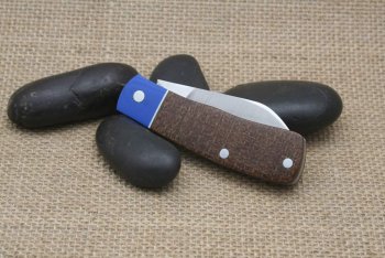

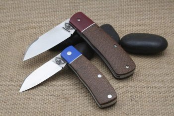

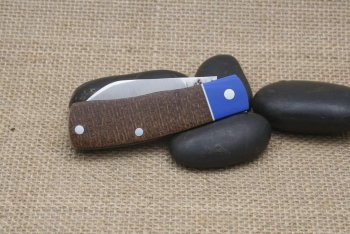

Mini Native slipjoint 25% smaller than the full sized Native this one is 5-3/4" long when open, with a 2.5" blade. 154cm blade and spring with stainless liners, burlap micarta scales, blue G10 bolster and a white G10 spacer. Thanks for looking, Please let me know what you think. *Available* Have a knife day

Both are beautiful knives. I love the contrast in colours on the scales, and the screws on the larger native intrigues me.
J.Leclair
Thanks, I'm very pleased with how they turned out. I actually intended to put the small one together with the screws as well but lost too many of the tiny buggers while trying to shorten them for the larger one. At least 3 went into my nasty spark catching bucket under the grinder and one or 2 hit the floor and bounced away to who knows where lol
Used a corby bolt for the pivot and peened the 2 rear pins. Other than loosing a few I deffinately liked using them just for the ease of assembly/disassembly while fine tuning the action. Then not having to worry about peening the pivot too tight. I've ordered in a bunch more and will be using them exclusively for my folders from here on.
