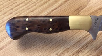

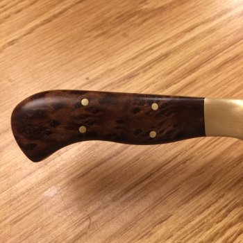

Just applied coat no. 3. Should be dry in the morning. The handles looks like ghost flames. Very neat and looks like fire when you turn it in your hand.

The tru oil finish is looking great. I don’t use tru oil a lot but like how it looks and actually like the smell. I haven’t tasted it yet. :oops: The character in the wood is really coming out!
Buffing in between coats with steel wool or 1200g will really make it shine, if that's what you're after. It flattens the oil finish, like car paint. Removes all of the small imperfections. Then reapply, dry repeat. Same technique is used for gun stocks.
As Vonbrom indicated. I use fine steel wool if the finish begins to look uneven. Not necessarily every coat. Usually near the end coats. It flattens the look out a bit. It also may require a couple more coats.

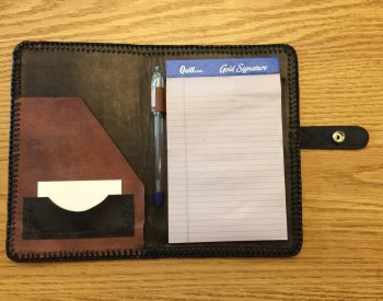

You are asking yourself, why is he posting pictures of a leather notebook cover. Well, this KITH knife will need a sheath. A sheath with a carved feather, hopefully. And, lacing on the edge. I am practicing the double loop stitch. Looking pretty good. Only took me five years to figure this out. Expanding the arsenal in the toolbox.

Experiment with different lace. It makes ALL the difference in the world on usage and finished product. The best of the real leather lace is called craftsman lace. If you want something that will hold up a little better, ProLace is a good option, although it is synthetic it's hard to tell on the finished product. I honestly try not to do a lot of lace work, I never make money doing it. It just eats up too much time. Herringbone and Mexican round braid are my favorites. They provide the best coverage on the edge and wear resistance. Your notebook cover looks great! Don't sweat the carving. Concentrate on getting good stencils and patience to start. With carving, a lot of times people get a little too ambitious to start with. Get some scrap and keep cutting. One thing I will add to that is this, your swivel knife is life or death. A high quality swivel knife yields high quality results. There are many custom makers on them and most are good.
Finished front, back, middle. There is no way that I could make any money doing lace. It takes forever. I am slow!
