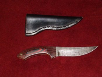

Although I've assembled knives for over 8 years (I buy the blades instead of making them so I don't call myself a knife maker), I just finished my first project with a Damascus blade:
The project revealed a very bad flaw in my technique. When I am sanding the handle down to fit the tang, I sand with the belt sander until I see sparks fly. Then I know to switch over to shaping the rest of the handle. I did this with the Damascus blade. After shaping the handle, I hand sanded everything (going from 220 - 800 grit) until I was happy with the shine. Then I buffed it until it glowed.
After delivering it to the customer, the first thing he said was 'Why is the tang so shiny? I thought it was made of Damascus also?' I explained how I put knives together and sand them. He loved the look of the knife but was displeased by the non-Damascus look of the tang. Which leads me to my flaw. How can I sand the handle to fit properly without disturbing the 'Damascus look'? I ask because I have 3 more orders for this same pattern knife.
Any suggestions are greatly appreciated.
Bob
