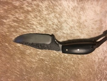

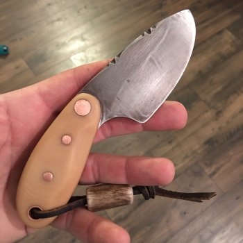

New around here and had some health issues that stopped me for a while, but found some issues and fixing them. I have about 40 knives under my belt and the first 5 a 10 were about as simple as it gets. Stock reduction with a grinder. All full tang knives and that is not where my heart is. Went to hidden or stick tangs and have now turned out 3 with 2 more in the works. I will add other pics so you can see the difference.
First one ever. Burnt the tip of the blade and proportions all screwy. Used a buffer to hide the flaws! Lol. Nice piece of wood though!

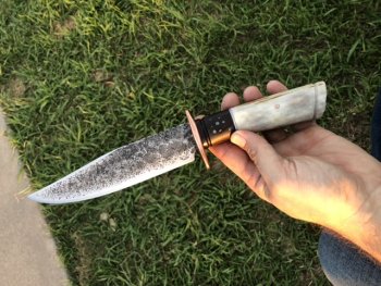

Several more issues came up on this one. I found curves easier than straight. Hardened the blade before I drilled a hole and could not get through it. Luckily the pins were done, but I was adding another and then had to just drill out a larger hole and fill with more rod. Oh well!

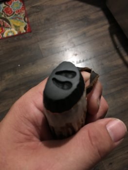

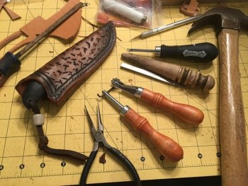

Started adding some leather. One pic was too large to upload. Work was improving, but still no greatness.

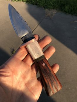

First partial tang and was proud, but still flaws. It still works great though. Kept adding to it over time.

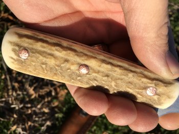

Another. Really like this package.

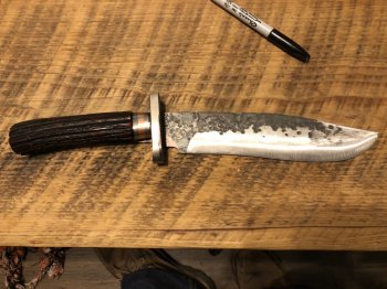

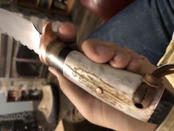

Then I traded a knife for a small anvil and forged my first knife. Custom steel star and other embellishments. Second partial tang. Rock solid and heavy! Lol I just gave it away a couple weeks back.

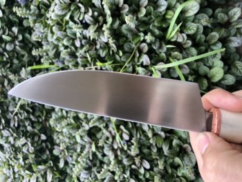

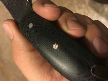

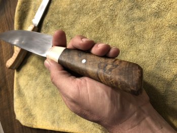

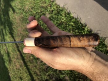

Decide to make a kitchen knife for the wife. Loved it, but the blade was still too thick. Still correctable, but I stop when things look Ok.

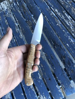

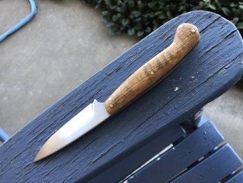

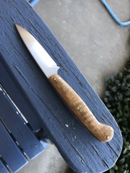

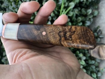

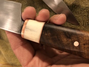

My brother wanted a paring knife. My best knife probably by that time. Only thing was he wanted light wood, and I used pecan that was not stabilized. The sanding process was leaving metal buried in the grain. So I decide to embrace it and and go for an oak barrel look. Tons of butcher block wax bugged into it to fill the pores.

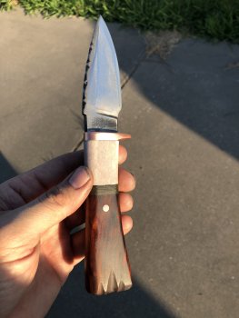

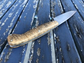

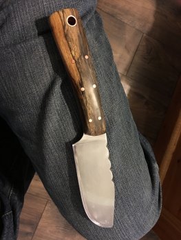

And this was the latest. Started out just using scrap but adding to my stick tang skills. For this one up nice, but still not quite right. I’ll throw some leather at it and give it away soon.

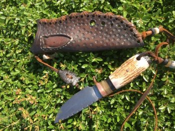

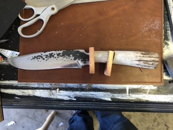

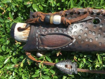

And my very special project. First time with stainless guard and bolster. Forged but having to adjust with grinder and I did not hammer in the bevels. So it’s a hybrid! I spent the money on a piece of my favorite thing in the world as I get bolder. Amber stag! MUST BUY MORE! Also my largest project to date and will need the new quench tank. First Hamon will be attempted. Plenty to do still, but will be heart broken if I can’t make it work. Already fixed the issue with the ricasso aligning with the bolster. Gave it a much better look. Lots to do......
Hey Beleiverjoe, these all look great, I am a newbie as well, so take this with a grain of salt. For the pecan on the paring knife, or just porous woods, I know many people use super glue to fill in all the little gaps. I have done this with minimal success, but it is an option. Most people call what you are calling partial tangs hidden tangs, but I think we know of what you speak :). Good luck with the big fellow, and I'm guessing some more experienced guys will be along to give some more critique.
