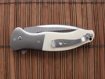

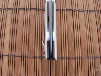

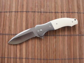

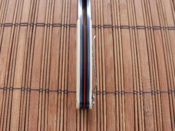

Really, cause I don't have a name for this thing. My mind is a total blank when it comes to naming something new lately. I can tell ya'all this, this knife is a combo of 3 knives currently in my lineup. It's got a little Impact flipper mixed in with some Irad flipper and a little bit of Active Duty flipper thrown in for good measure. For now I'm just calling it Mutt, unless somebody can come up with something better. Help! Till then I'll just get to the specs.
4'' blade(tip to bolster) of S30V @ 60rc. w/2-tone satin finish.
.080 Ti liners jeweled inside and anodized blue.
Ti bolsters orange-peeled as with the Ti clip.
Ivory micarta scales.
Black G10 w/red spacer backspacer.
5 1/4'' closed.
Sorry, crappy pics
