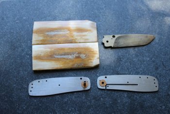

I am using some Mammoth ivory scales on a folder and am looking for some pointers on cutting ,polishing , drilling and such . any help will greatly appreciated .

Those look like really solid pieces (don't see any cracks/checks)..... that will make thing easier. Looks like theres not a lot of "bark" left! :) (We all do that when we first work with this stuff)
Ed , is bark the grayish brown area on each scale, I intended to incorporate that into the handle, is that a no no.
The color is what most refer to as "the bark"...... its generally only a "skin" on the outside of most fossil ivories. In the pieces you pictured, it would be the tan/brown stuff. Ideally you want to leave as much of the bark/color as possible on the finished scales. The hardest part for most folks who are starting to use fossil ivories, is NOT grinding/sanding off the bark.
Generally, the deeper the color runs in a piece of ivory, the more expensive it is. Color wise, blues and greens are the most rare.....the most sought after, and the most expensive.
I am finding that establishing a flat is difficult , I am finding small cracks that I'm repairing before continuing. This material grinds tough.
