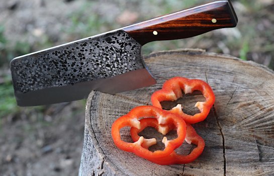

I like the look of the hammered look on some of my bar stock knives, but my shoulder doesn’t. Any ideas that could get that look with the least amount of work? I have using a ball peen hammer. a small power tool or a using some other physics I don’t know about?

This is an example of the results
While the final texturing is appealing, there some things to consider. First, pounding steel in a cold condition distresses the surface and work hardens it. To relieve that stress it's probably a good idea to normalize the blade before HT. But, since the stresses are on the opposite side of the blade edge, I haven't found this to be a problem. I would definitely normalize a long blade.
This surfacing technique will also result in lateral distortion of the blade if the amount of pounded / upset metal is not equal on both sides. That is an issue that needs to be fixed either by uniform pounding on both sides or during the tempering process. Again, I've not found this to be a problem.
