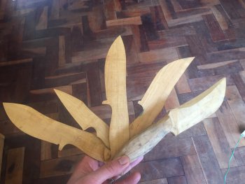

Here's one I designed had approval from the customer. We were both excited. I made a template, and it was just to uncomfortable in the hand to proceed.

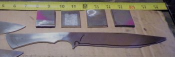

I really like that Justin. How thick is it going to be at the spine? How are you going to mill in the fuller? You need to sand out those grind marks near the plunge lineI'm home with a sick boy today. He is asleep so spent a little time working on this camp/ranch bowie. I drew it up the other day but it needed some tweaks and I ran off the paper.This one I am going to make for me. Handle will be desert ironwood not sure what the steel will be yet.
Probably 3/16" thick. I'm not sure on the fuller, last design I drew it ground in with like a 2" wheel. This one would be like a 1/4" round end mill. I have a friend JPSworks who lives about 40 minutes from me that has a milling machine so I may go that route.I really like that Justin. How thick is it going to be at the spine? How are you going to mill in the fuller? You need to sand out those grind marks near the plunge line!
