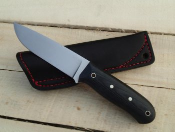

Here is a nifty midsized camp knife for general purpose camp use. It is made from 3/16 1084 high carbon steel which has been differentially hardened. A full flat grind makes this knife capable of chores ranging from light batoning to food prep. Included is a matching custom sheath from AK Carrigan.
9 3/4 OAL

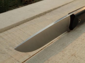

4 7/8 blade
Tapered Tang
Distal Taper
Stainless hardware

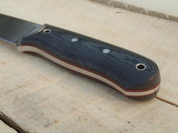

Black Linen Micarta scales
Red G-10 liners
8.4 oz balanced right at front lanyard tube

Very nice, your going to mark that aren't you Jon ?
Thank you. It is marked, but my etch did not go as deep as I would have liked because I used an old stencil which I discarded after that blade. I had a metal stamp made up but have not yet taken the time to build a proper holder for it. I am often concerned that a shallow etch such as this could be sanded out and 're-purposed' by another at some point in the future.
