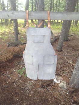

Figured I would post up a picture of the one I make and revive an old thread. You can stand in the spark stream all you want with this one.
