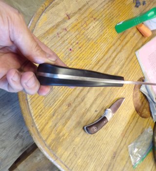

Thanks for all the tips/advice. If I get it fixed anytime soon and it turns out ok I'll repost some pics. Planning to saw off the scales, clean the blade up, put bolsters on, and divot out the crown. Then reassemble. Not now though.
-Luke
Nothing to show I sawed scales off last month, broke them, and scratched it up. It needs some clean up so it's on the shelf for awhile. Thanks for the advice to not sell. I also noticed after 7-8 months the five minute epoxy was pulling away from the steel.
Luke

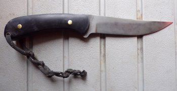

Finish this. It's not a gem, but way better than the original.
Blade is D-2 from a commercial supplier, handle and finish are by me.
Dyed birch scales, peened brass pins, and tried a forced patina. Lots of firsts again but I think I learned symmetry on knives is better than "unique." Maybe a right combination of the two is what to shoot for.
