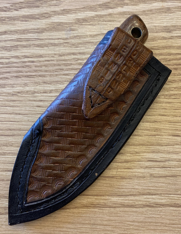

Everyone starts somewhere. I have built a sheath for every knife that I have made and maybe a few extras. This is No. 1.
I finished it almost 10 years ago. Wow, I am old. I wish I would have started earlier in my life. I start at age 46. I am almost 56. Crazy!!
Practice makes perfect, I needed more practice. And a bunch more tools. And some great tips/guidance.

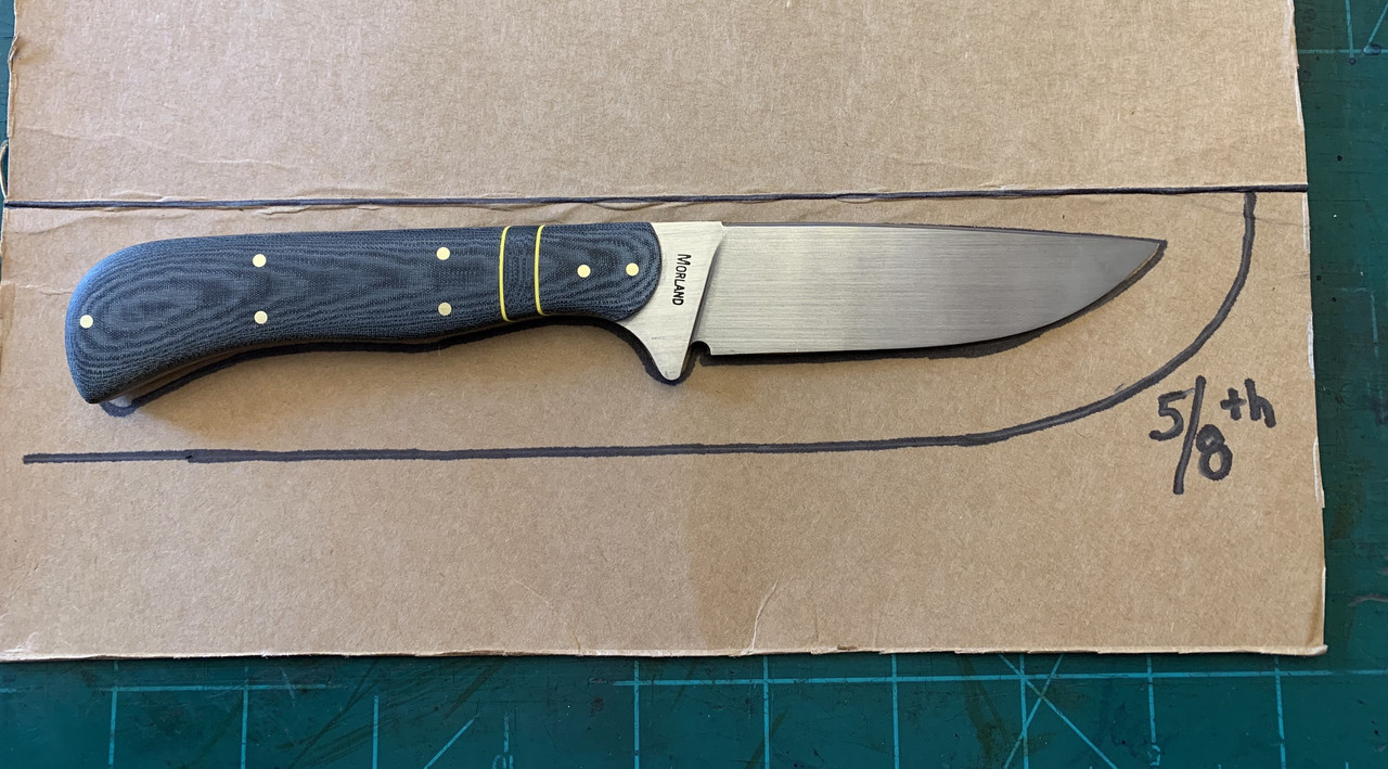

This will be the knife that goes into n the sheath. It is not quite finished. It is getting there. I like to have the sheath finished by the time the knife is sharpened. Should just about work out.

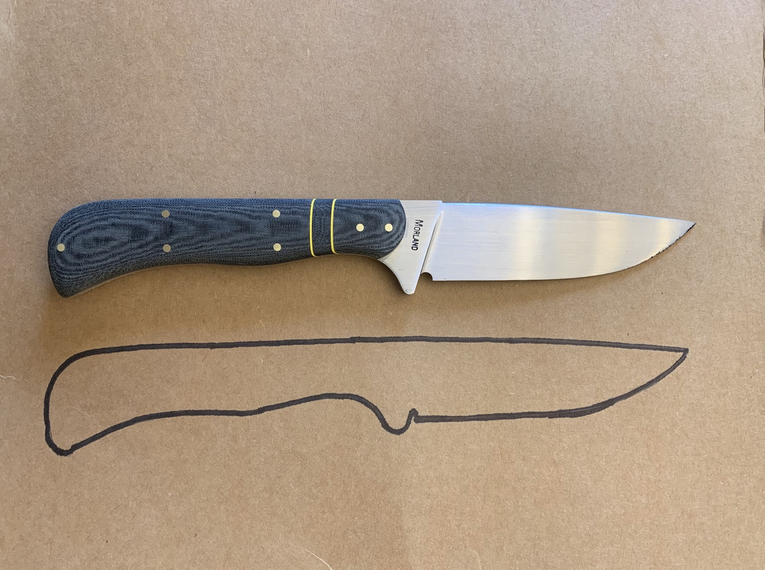

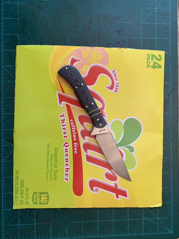

I use old soda/beer cardboard containers for my patterns. Cheap, abundant, and easily recycled.

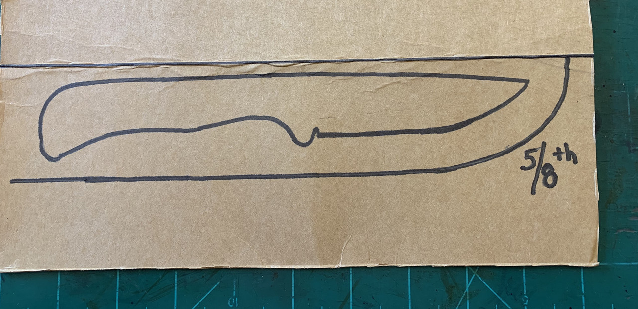

On the cardboard side, I draw the knife.

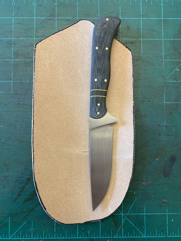

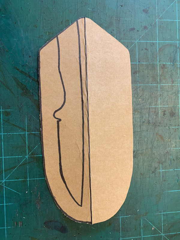

I then draw a line about 3/8 inch from the edge. I fold the cardboard on that line.
I then draw a line about 5/8 inch from the blade edge and bottom of the handle.
Man - I dig the pin placement and sizing on that handle - really looks good sir. Thanks for sharing your knowledge of leatherwork, you are quite talented.
I like my sheaths to be longer than most. My reasoning is to protect the handle as far up as possible. So I draw the line at the back of the knife.

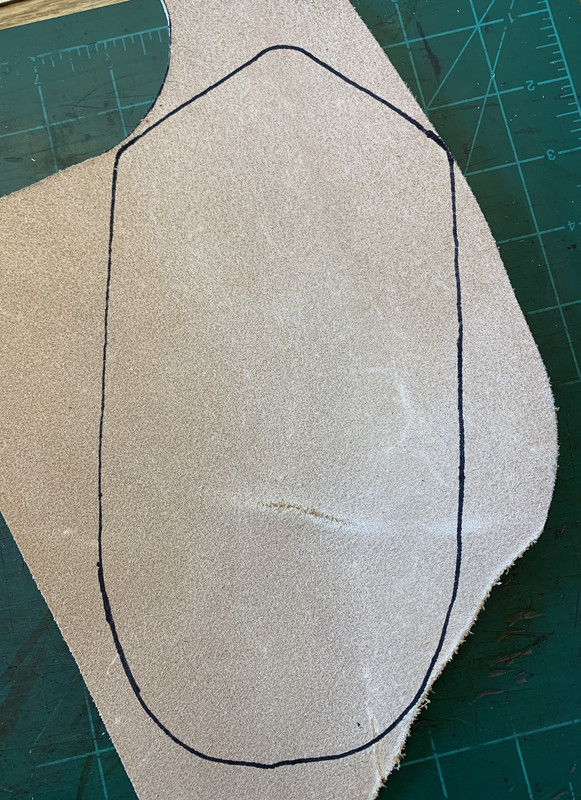

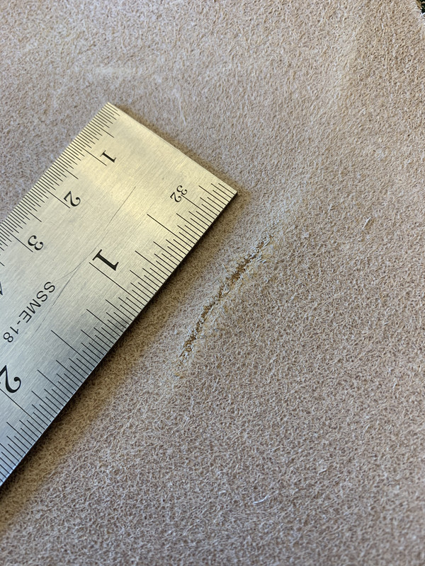

I have a smaller piece cutoff of 5-6 oz leather. Should just about work for this sheath.
It does have a small weak spot on the flesh side. I will try to cut it out or place it somewhere that it will not bother the functionality of the sheath.

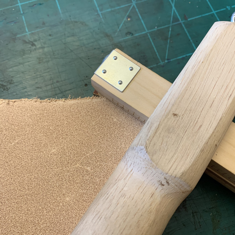

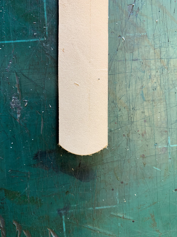

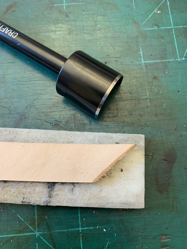

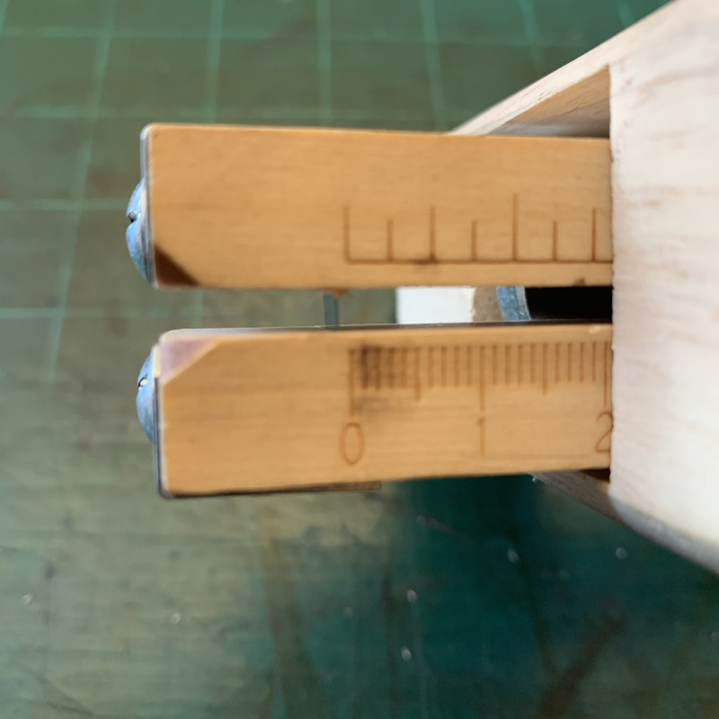

This is an adjustable strap cutter. It cuts leather straps. I set it a 3/4 if an inch for the belt loop.
I am not sure you can see it but it has a razor cutting blade in the outward arm.
Just set the leather against the guard and draw it through the razor cutting blade.

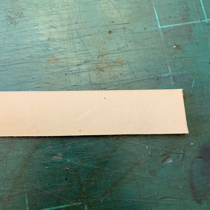

You get a nice straight cut strap/belt.
If you do not have a strap cutter you can use a straight edge/ruler and a sharp blade.
Mark out the sheath body. I call it the shield. I could not get rid of the weak spot so I put it at the bottom of the sheath. It will not be a problem, I hope.
