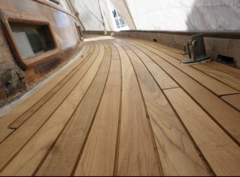

I would not. Teak, while dense, is not hard. In fact the 2in x 2in teak board that I used for the handle took a warp in my shop just from leaning. I stood it up in the corner for a while before I got to the project.
Teak bends very easily which makes it perfect for rub rails and decking on boats. It is commonly edge set for decking. “Edge set” is a boat term, meaning that you lay the board long-ways and flex it sideways so that the edge butts up to the edge of the board next to it. In this manner you get deck planking that follows the lines of the boat as it bows outward at its widest point and then pinches in again. This seems like a trait that runs counter to what would make a good axe or hatchet handle. Teak is about as soft as Ash or Hickory is hard, if that makes sense.
Here’s an example of edge-set decking on a sailboat.
John Thanks, I am glad I asked. I was hoping to get a free lunch with the teak. It was pretty but not worth it. I think I may use it for shelves in my coastal kitchen.
