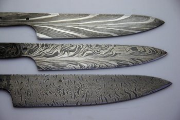

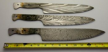

Three new ones unfinished
gearhartironwerks
These are 1095/L6. The larger is 5160/L6.
Thanks for looking. Comments welcome.
John

No names...couldn't repeat them if I wanted to. The top two are obviously feathers. The top and middle were random patterns that had absolutely no interest as forged, so I cut, added a layer of L6, then welded, slit for the feather, re welded, turned and drew them out. They were some of those nothing ventured, nothing gained blades. The bottom is a 'w' pattern which is pretty hard to mess up. I have to say though, I like the randomness of some damascus despite not being what I had in mind. It's kind of like Christmas when you were a kid. :).

These are great looking Dammy blanks you have forged. Have you decided if they are going to be flat or convex grinds? How about the handle materials?
Stabilized Cal Buckeye gets my vote for # 1!!
Do you forge Stainless Dammy too?

They all have flat grinds. Convex on the final sharpening. Cal buckeye gets my vote too. It kind of depends on what I can find.
Haven't done any stainless damascus per se, but have done some san mai billets w/stainless out and a 1095 core.
