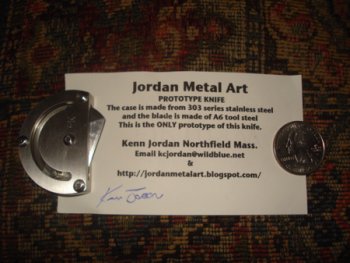

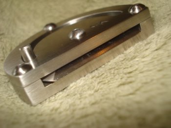

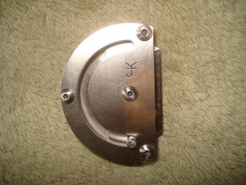

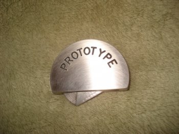

Here are some pictures of a rough prototype I thought I'd share. The case is made of 303 SS and the blade is A6. Now that I have something tangible, I can see things I like and some I'd like to change, but this is the general idea. As of now the physical dimensions are 1.750 O.D. X .300 thick. Please note that when the blade is in the closed position all you will see is the outside profile of the case. In case you're wondering I'm going to use a ball detent for a blade stop. I now need to fabricate a new blade for this configuration that will protrude from the case about .500 thus allowing me to grind an angle back from the .500 to about .375.
Thanks for looking, Kenn
