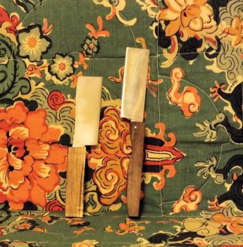

I have always wondered how thin can you go. Bought some steel that has an interesting description:
the steel is 100MnCrW5 specially modified with 0.2% vanadium manufactured by a multi-generational family business in the cliff side town of Thiers, France. located above the Durolle River, the village of Thiers has a tradition of making cutlery dating back to the 14th century.
got a piece that was 0.75mm(0.03") thick and cut some basic blades, 4"x1 1/4" blade with 4"x 3/4" tang. my biggest worry was warping during HT. pre-heated furnace to 1475F, 5minute soak, a second or two in warm oil, then between aluminum quench plates until cool. 2 1hour tempers at 350F with cold water quench in between. 12 point hardness check averaged out to Rc62. the steel is so thin i just did a 10 degree bevel on each side. works well in kitchen on boneless beef and vegetables. handle on the right is black walnut, on the left is honey locust.
